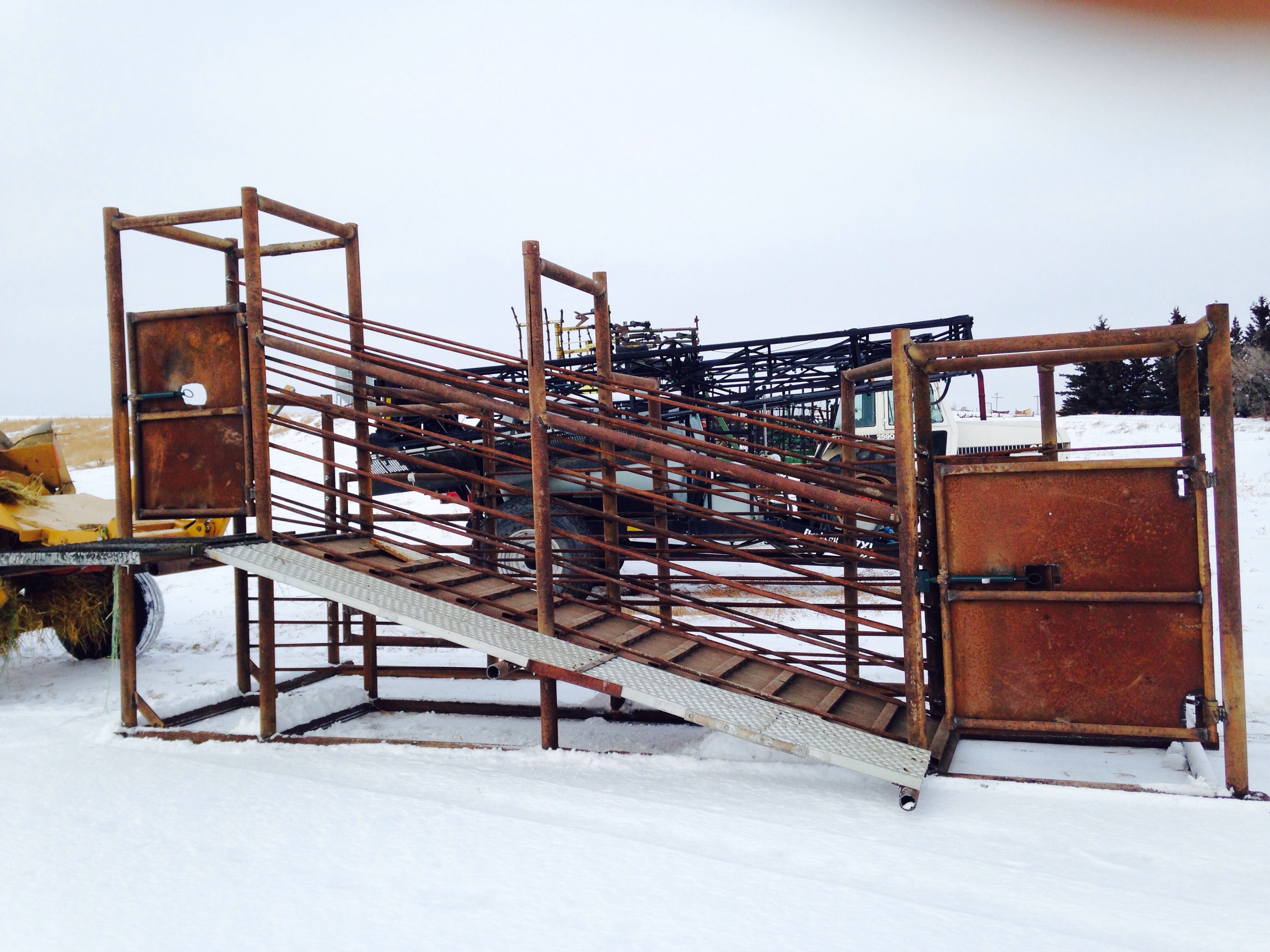

              Finally got my loading chute mostly done.
              Have to cover sides in but will paint the metal first.
