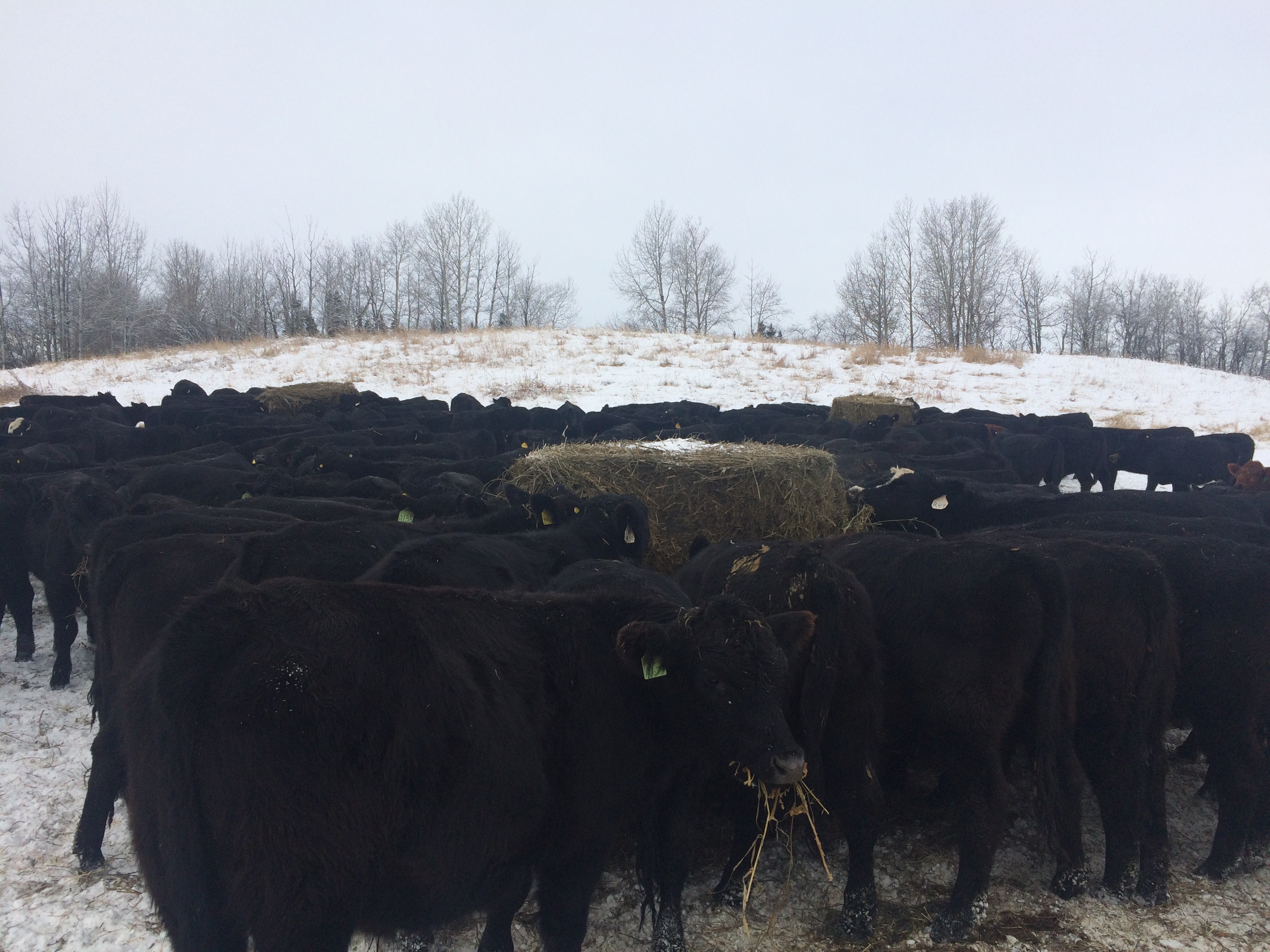

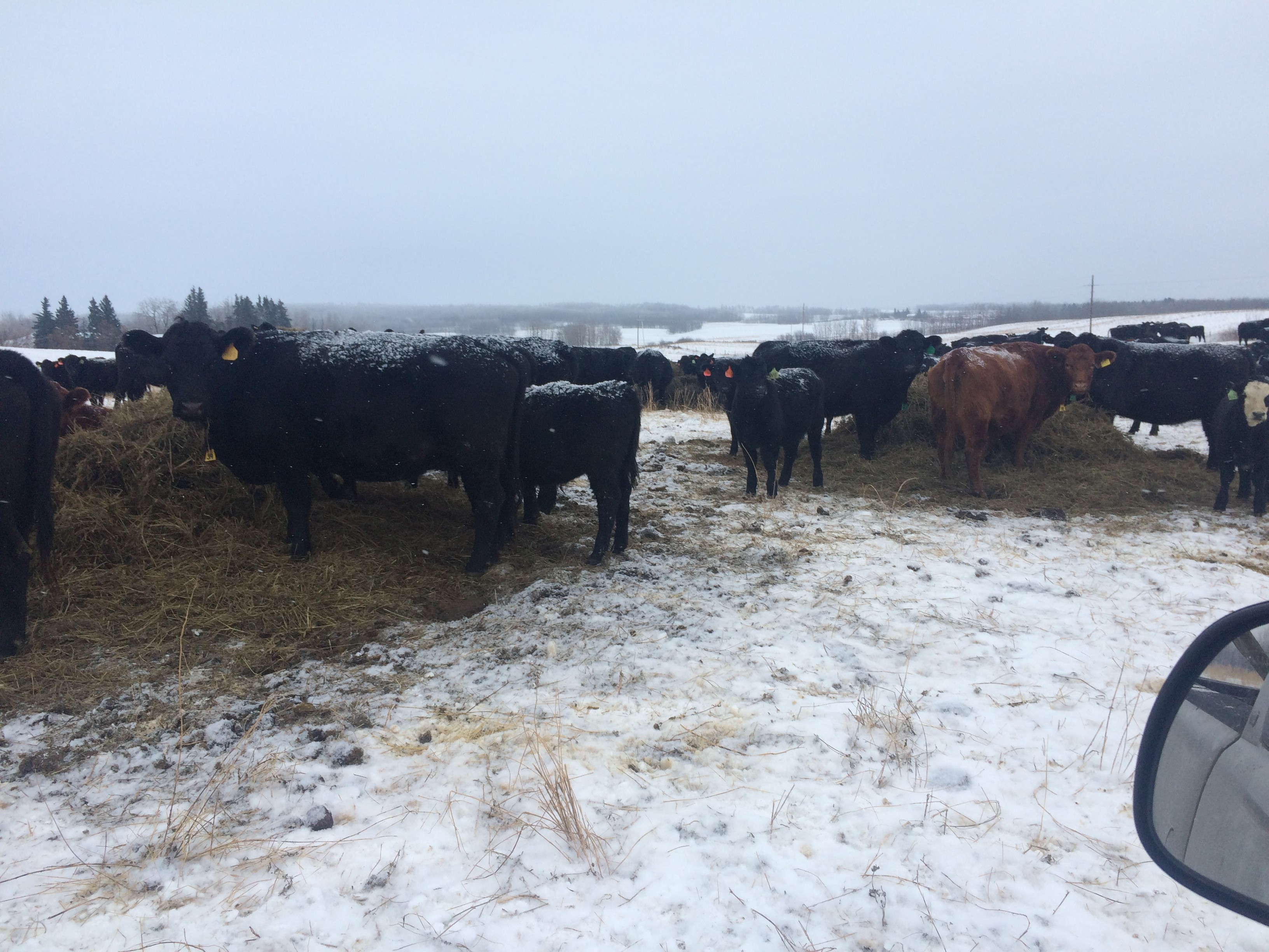

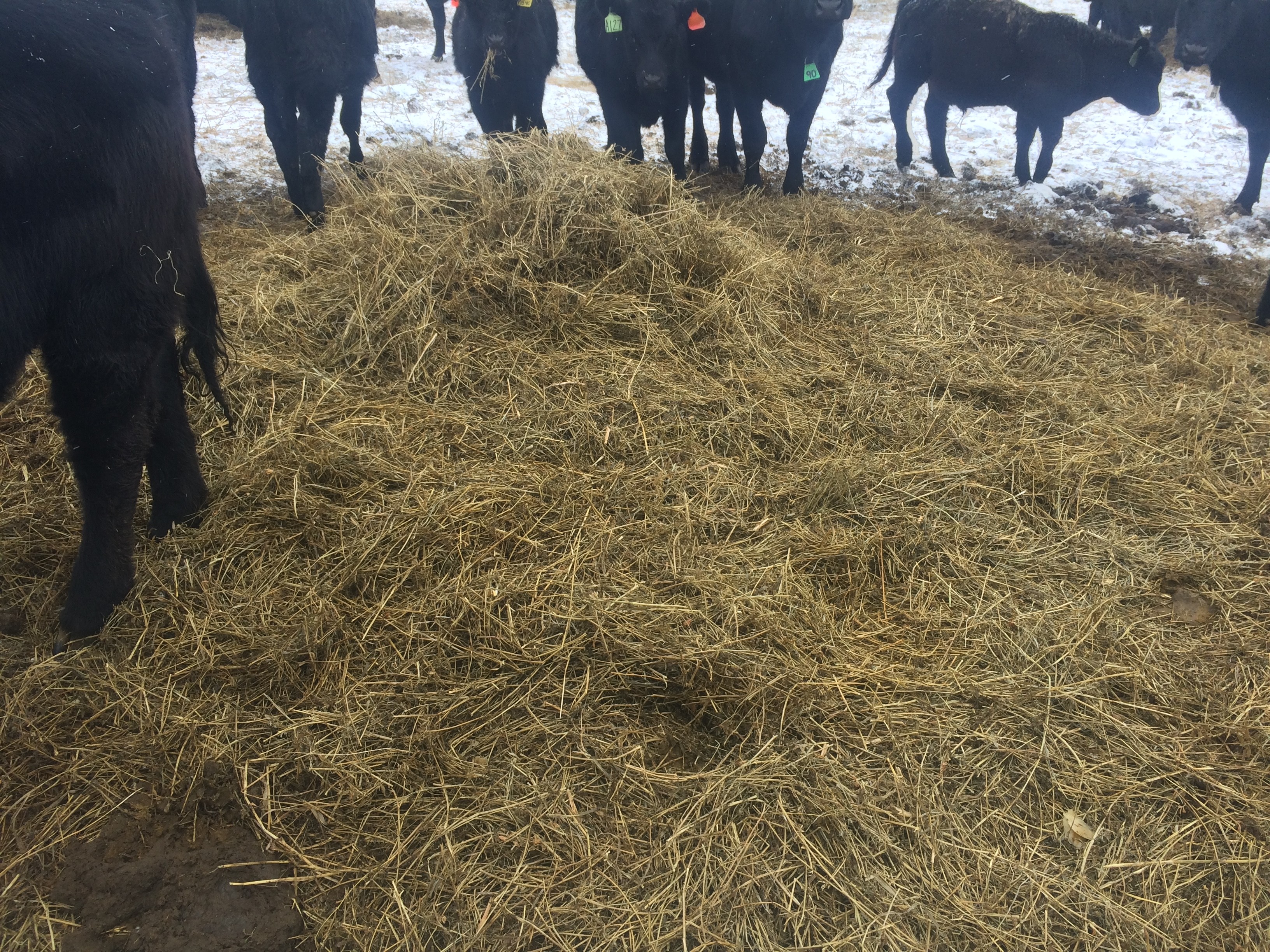

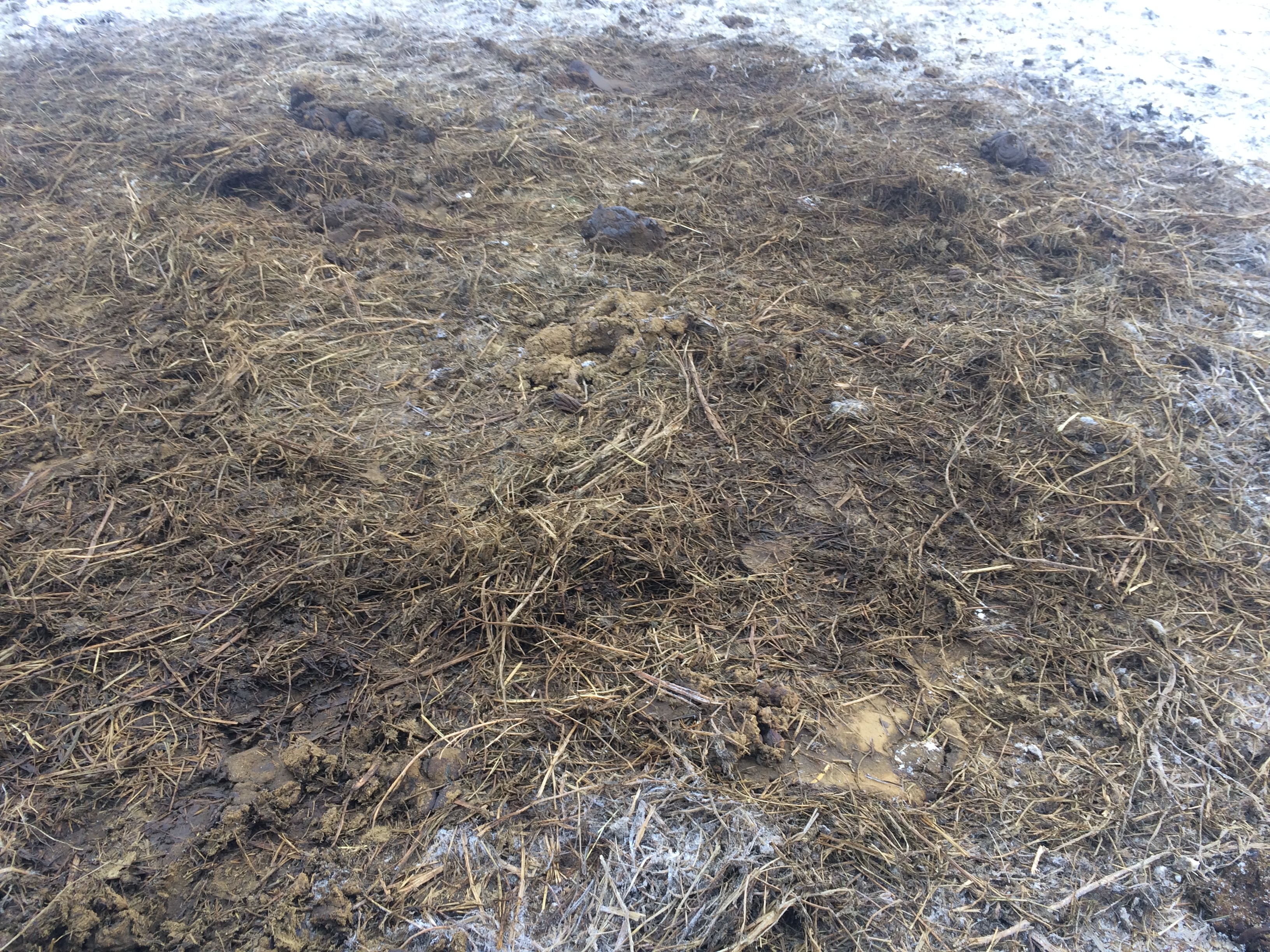

            Day 0
            Day 1
            Day 2
            Day 3
            Quite impressed with how it's going so far. They're mostly leaving behind the weeds since their stalks are really coarse and that's fine with me. Takes two people about six hours to feed for three days and that's with moving the bales 12 miles. For 500 pairs and 450 yearlings I think that's quite ok.
