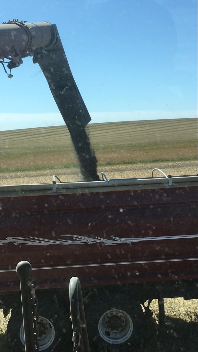

                    Anyone with a case IH with the extended auger , this will help in the wind ....
                    After the first hopper yesterday I thought this is b/s . There was no way I could unload at all into the tandems .
                    Canola was to tough yet so back to the yard . Grabbed a swather canvas , a flat iron and my drill .
                    1/2 hour later I made the FTWE.
                    It worked great all day , could unload on the go any direction into tandems in 60 plus k winds .
                    Saved a pile of time and frustration.
                    I hate losing time when there is a weather change coming
