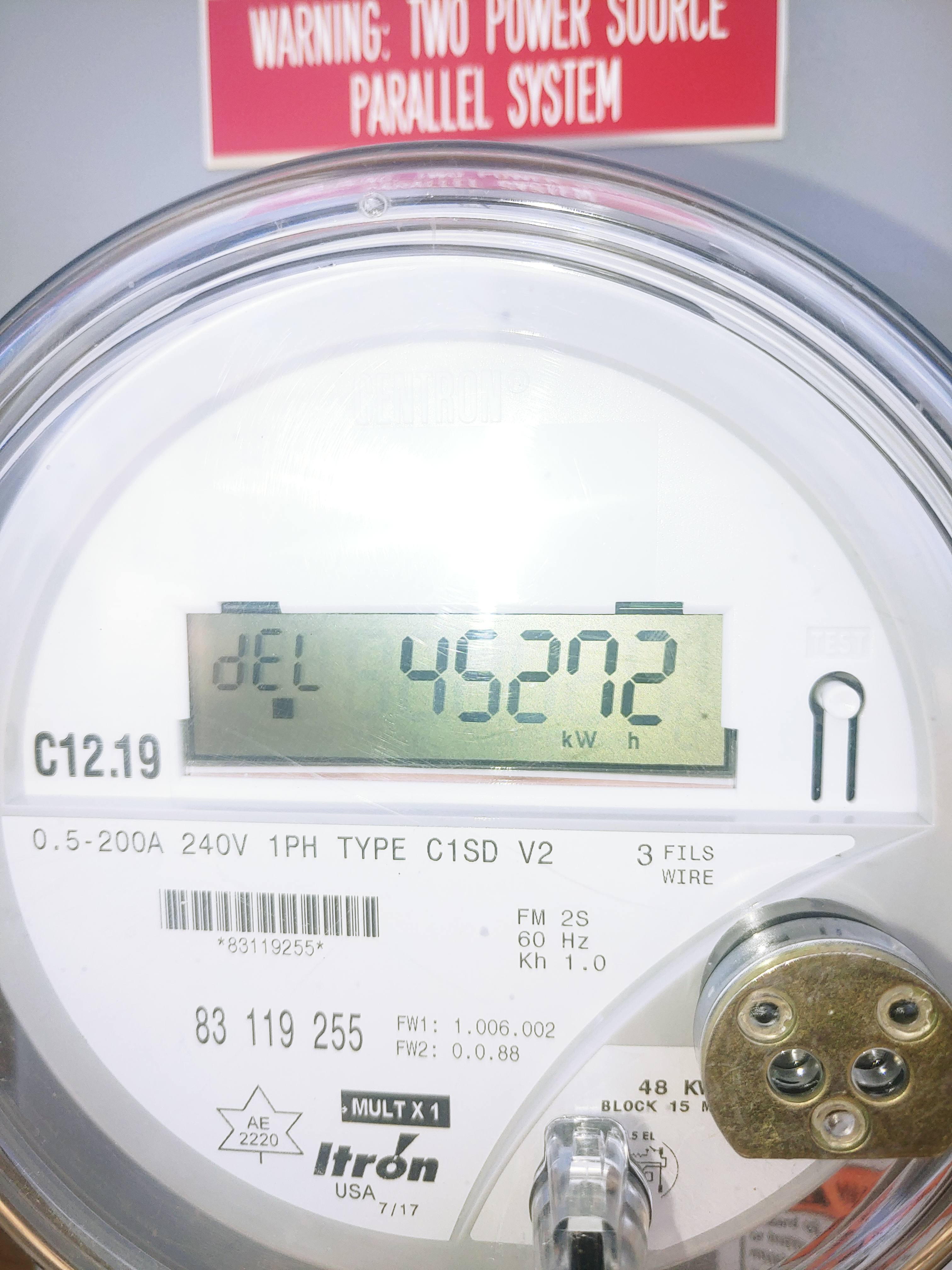

    Actual production here in Saskatchewan.
    3 banks of 12 panels. Fronius inverter.
    790vdc input. 230v single phase output
    Maximum licensed production = 13,340 watts (13.34kw/hr).
    First, current production, Thanksgiving Sunday at 3 pm partly cloudy 70km an HR winds, 11,900 watts = 11.9kw/hr.
    365 days received from grid.
    Keep in mind pump, water heaters, electric water heater and electric furnace.
    Now, power delivered to the grid.
      Looks good to me.
