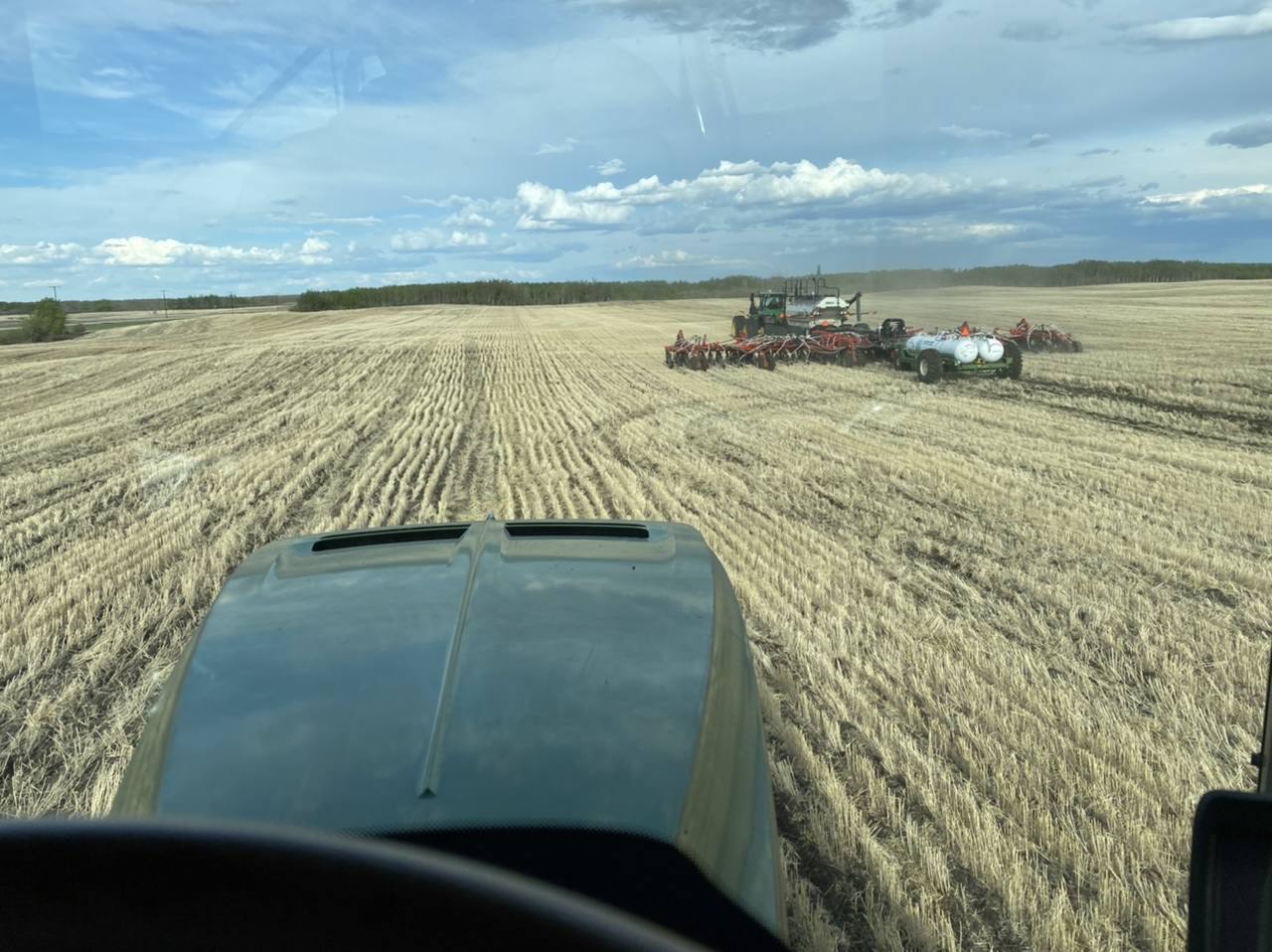

    Plant 21 is in the books as of late yesterday.
    Got to play in the mud on our usually wettest farm.
    Few experiments
    140lbs actual N
    Plus 120 lbs S15 actual

            We have 40 Acre test plots seeded to Canola with 160 lbs N 120 lbs S15 and potash plus coated with Zink.
              That seems a bit on the light side for Sulfur doesn’t it?

                  That's 18 lbs of actual sulfur and our soil tests show we need 15 lbs for 66 bus.
                    what is it? 140Lbs N or 160 lbs ?
                    My 140lbs N and 20lbs S the last 3 years showed no real economic benefit compared to 120 N and 10 S..

                      You guys are pushing lots of product! I'm putting 345lbs down and thought that was lots.
                      I seem to recall a discussion with a canola agronomist one time that said 140lbs was max N useable by canola plants. We go with 100-30-20-25 on our canola and use 30% esn and this year did use MeS15 for phos and sulphur. We have 6/7% organic matter and usually no shortage of water that also helps.
