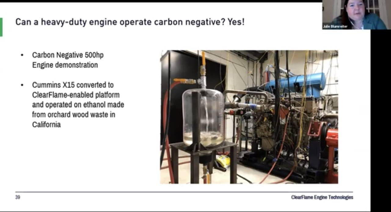

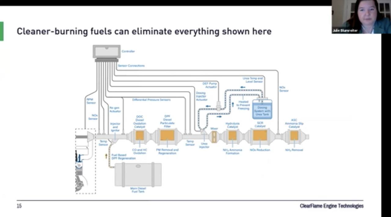

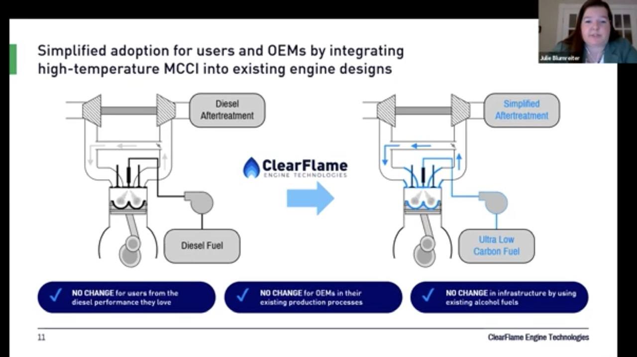

                    Ethanol can be used in Diesel engines, 1.7x diesel energy density. No particulates, Nox reduced over 93%… same power output as normal Diesel engines… no after treatment needed like diesels need now.
                    There is no need to go to electrical batteries for our equipment energy supply on our farms. Ethanol is less expensive than diesel on an energy basis right now.

                      Seems like a workable solution.
                      I'm sure the food versus fuel debate won't be reignited during a time of supposed global famine.
