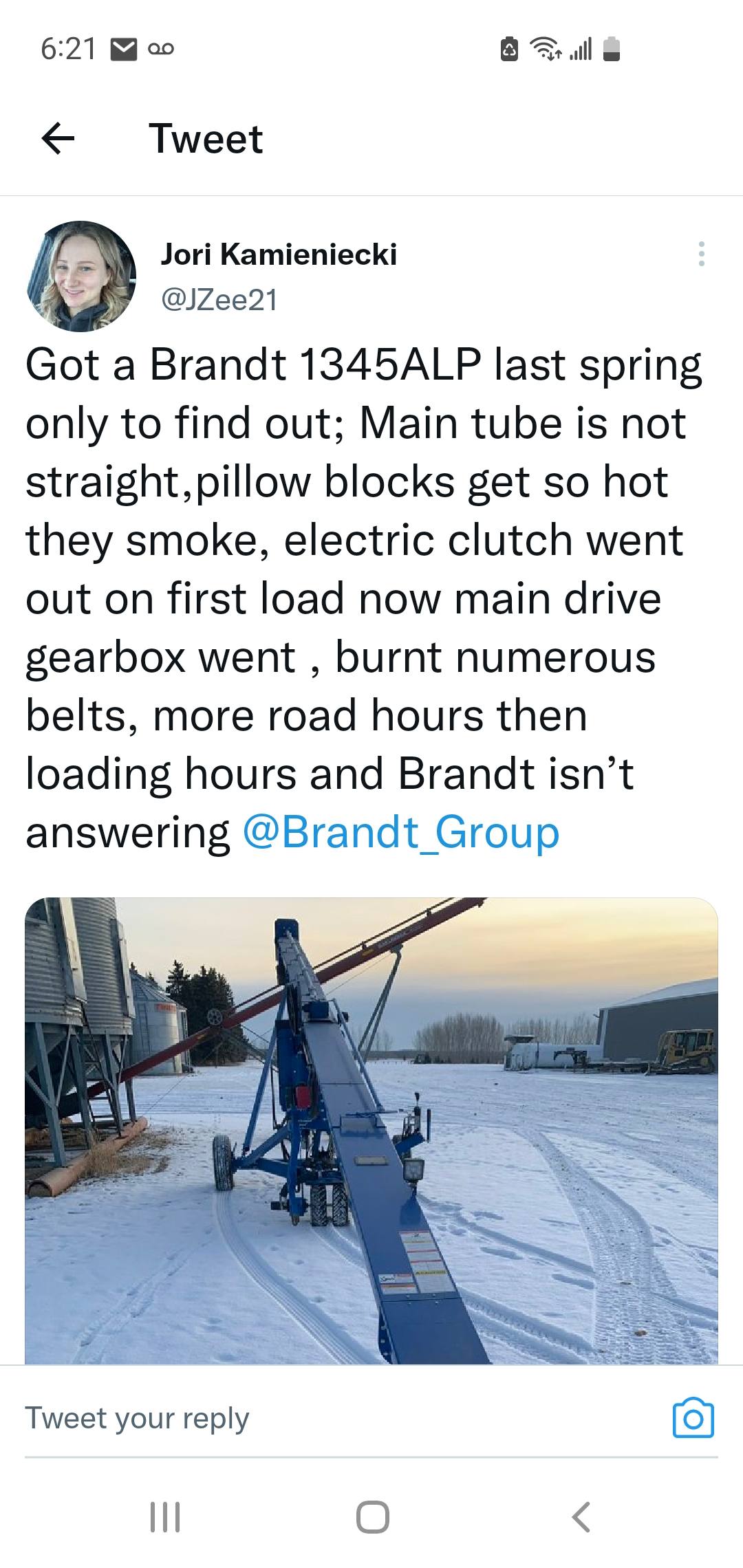

              Bought a new Brandt conveyor, waiting for its arrival, sure hope it works good after hearing about these U troughs. Crazy prices on these things.
