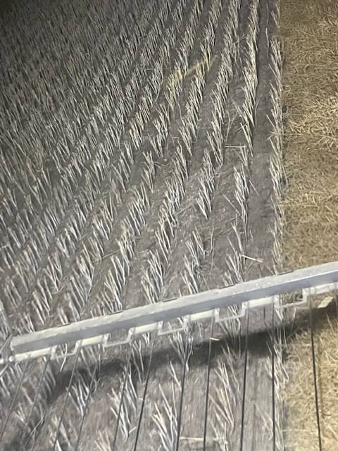

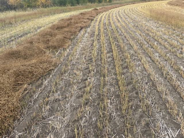

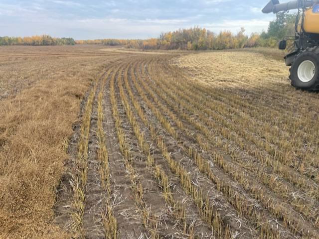

    I think you could go lower seeding rate yet.
      2.5 lbs
      3.5 lbs
        Yield was very close
        2.5 lbs was 290 bus
        3.5 lbs was 283 bus
          Ya I think 2 would be lowest in ideal conditions
          Still have to worry about frost and beetles
          Will do most at 2.5 next if not too dry at seeding time .
          This spring was ideal conditions, 3.5 too heavy in our low rainfall area around home . Simply burnt out to quick
          Here was 6 in rain so enough to carry 3.5
            Hey Furrow, how wide are your packers on your paired row? I was planning to do 3 1/2 inch also even though my packers are also 3 1/2. They say not to do that…that the packers should be wider.
              Our packers are 4in
                Originally posted by Jay-mo View Post
                Does it actually leave a space between the paired row or does it basically just turn into a 3 inch spread?
                Flax paired row ..
