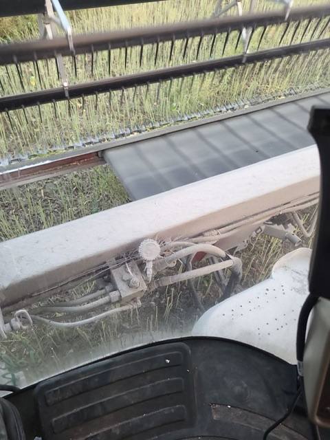

    Anyone know what the white powder dusting off in canola is this year? I have never seen this before. It’s only in the Invigor varieties I have noticed when swathing at a pretty ripe stage. Seen it in L345 and L356, maybe only slightly in L343. Not in any Pioneer, Brett Young, or Canterra, and not in L340. Powders up the swather like icing sugar blowing in the wind. Worst in low areas.

        Googled up white dust in canola. Apparently there is a type of powdery mildew in canola. My swather is all white just like the one in the pictures in the link below.

          Yes combine is white from it invigor pod seal variety . Might have to turn ground back to cow pasture. Its still out yielding my sons Bret Young canola thou.

              Had it all over our canola last yr.. combines were brown white like a dirty chalk dust. Agronomists said it was some form of powdery mildew...
              Almost sticky.
                Yes it’s a type of powdery mildew
                Warm falls and higher humidity areas , generally in later crops
                  Fungicide made a big difference on our Canola… it was clean. Fields without… were very dusty…

                    Fungicide made a big difference on our Canola… it was clean . Fields without… were very dusty…
