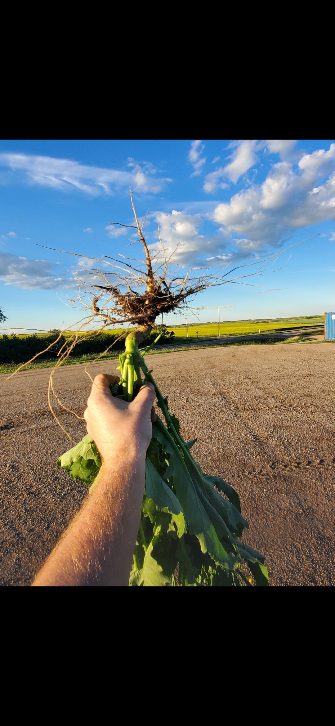

                    top 2 plants are check vs bottom 2 in rhizophagy with pgrs. note the root growth difference and branching difference between the top 2 and bottom 2
