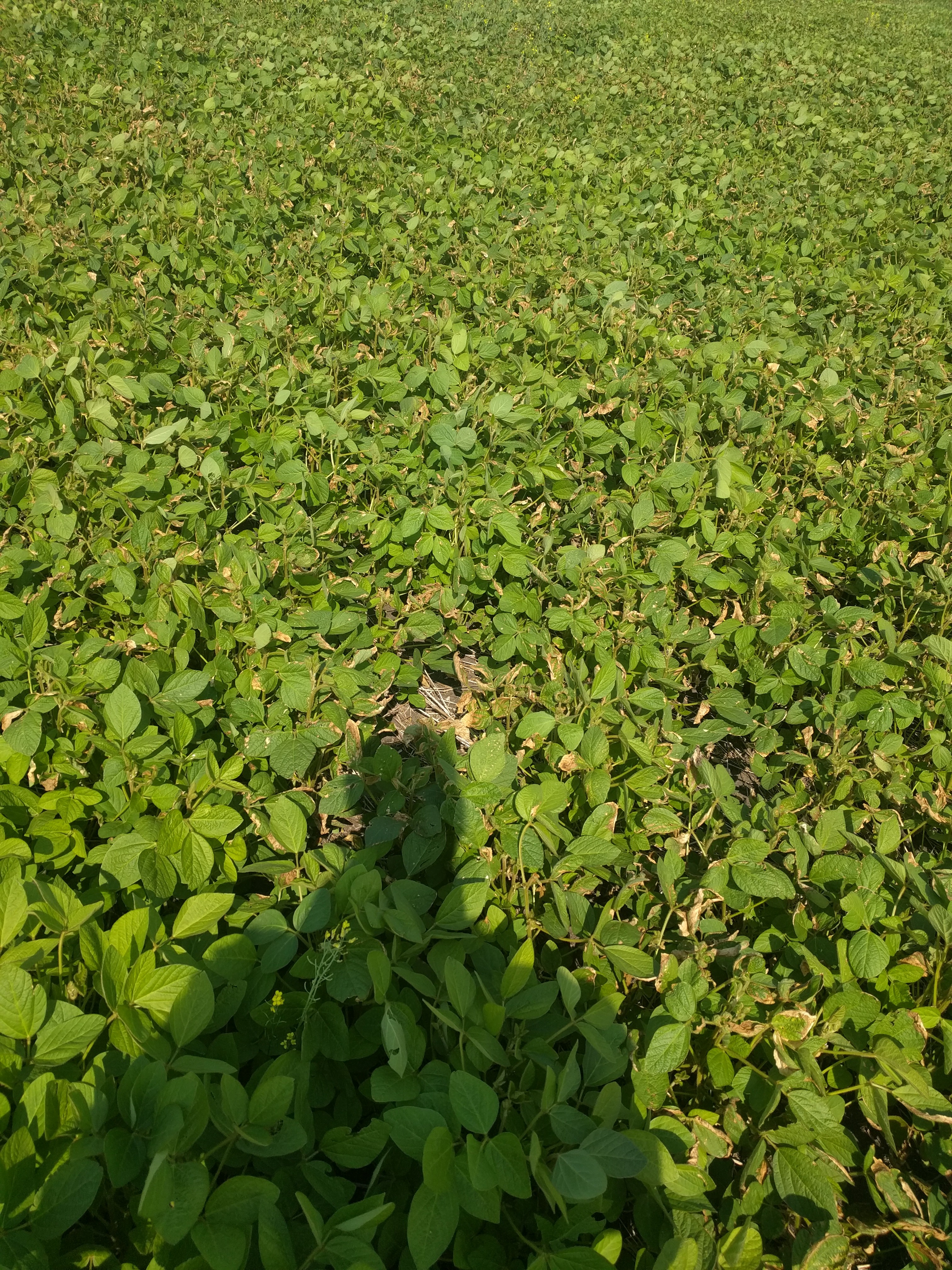

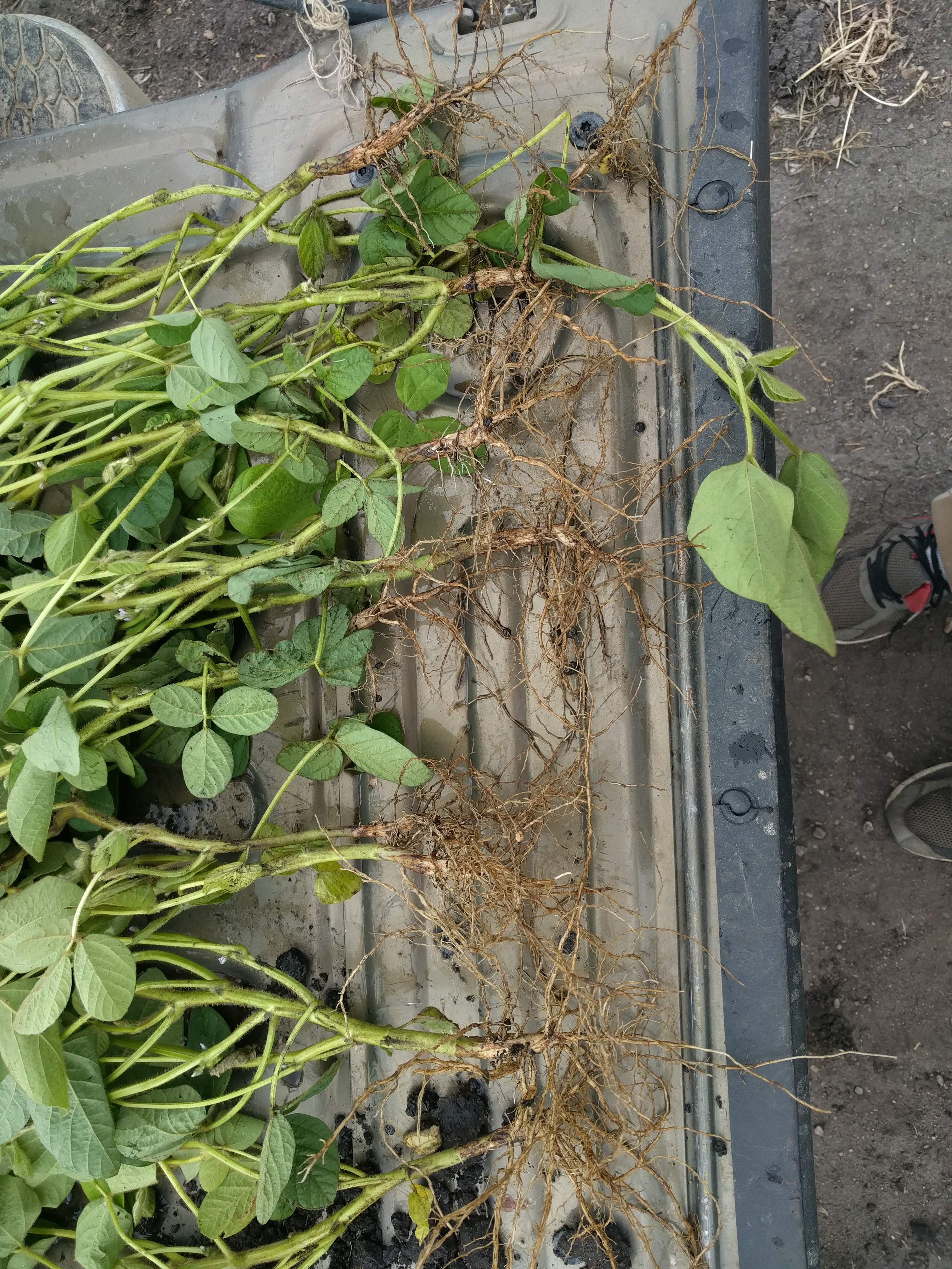

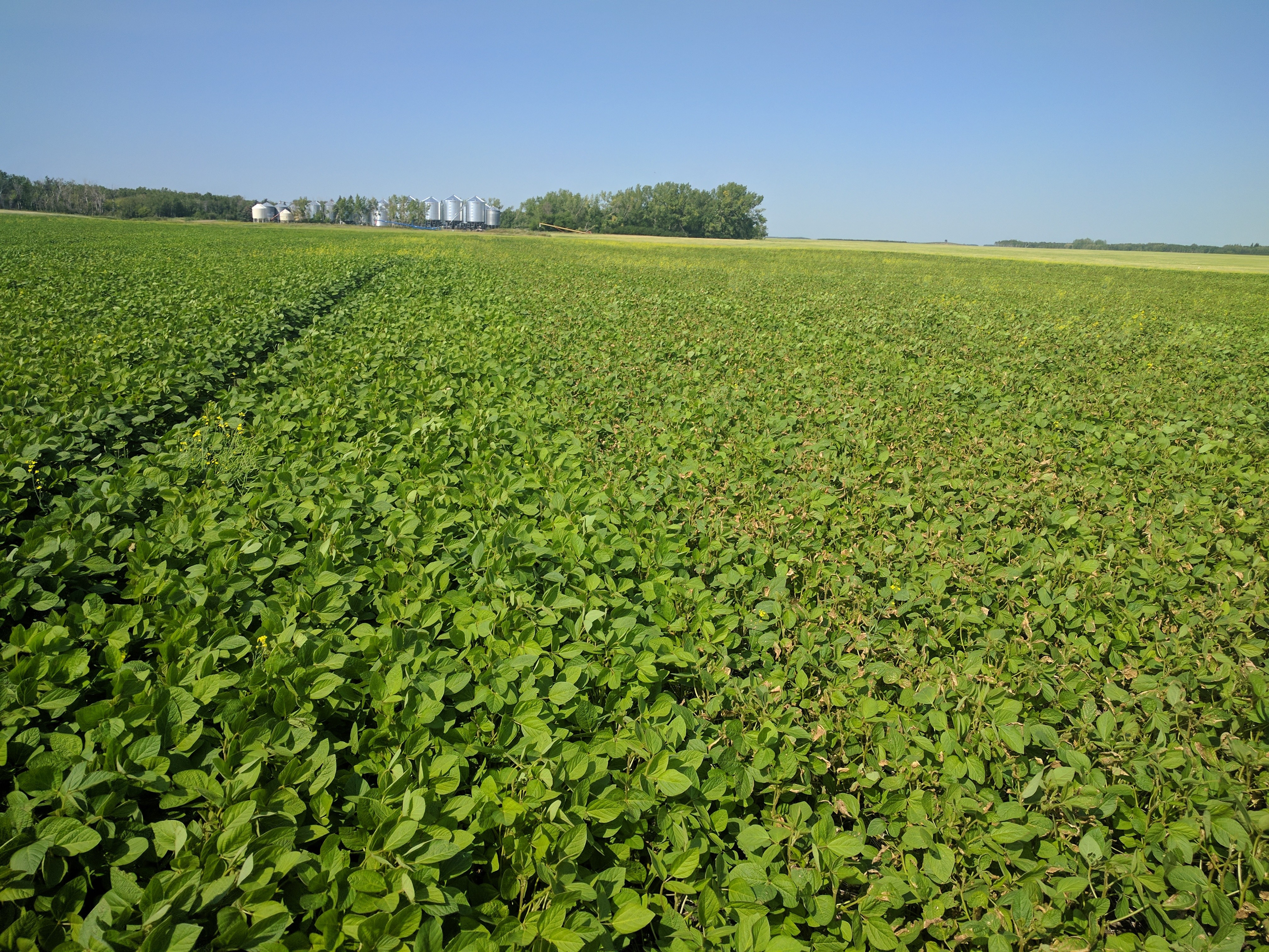

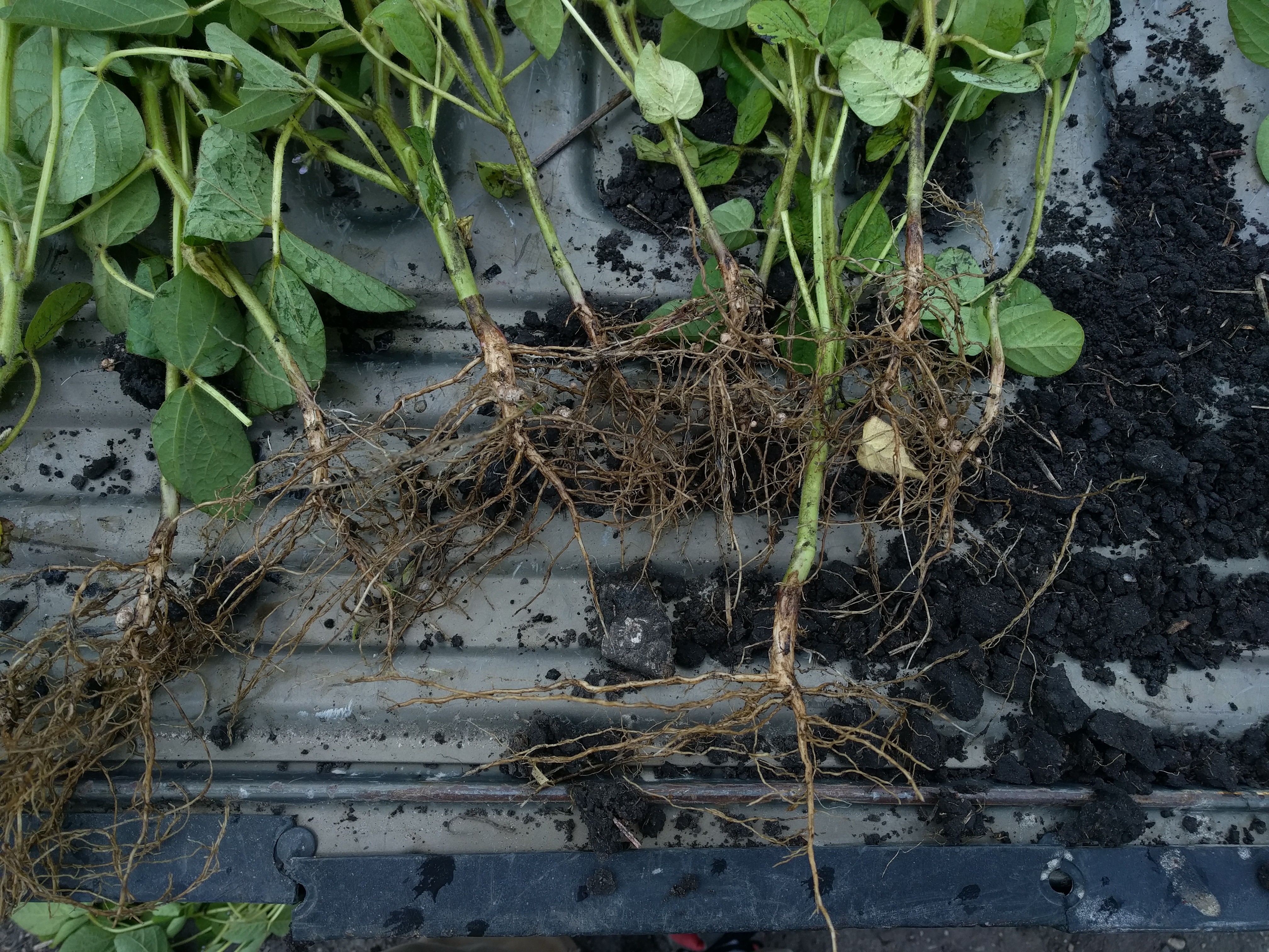

                  First time soybean grower, and my beans have poor nodulation. Started out in July with 1/3 having nodules and now it's maybe up to 75%. They where double innoculated with tag team and whatever came on the seed. For the most part the beans look healthy, except for areas with compaction or salinity. They are halfway between my knees and waist in height.
                  I did stream on 45lbs of actual N on a few test strips, and did it ever burn the leaves. Set it back by at least a week.
                  The first pics are of the leaf burn, then some root pics and their lack of nodules
                    • 17489
                    Good pics Wheatking and nice job of cleaning those roots off. At the very least I could have dug some pea plants up and looked for nodules as well.
